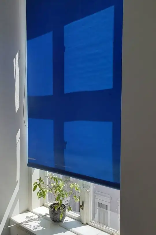

I have an IKEA window roller blind similar to this one. The material is 100% plastic.
It is however dark blue, so it absorbs a lot of sunlight and so it warms up the apartment.
I was thinking of buying some silver paint spray and simply painting it over so that it reflects the sunlight.
Would this work? Or would the paint simply start sticking to itself when it's rolled up (every day), or fall off?
What kind of paint spray would you buy?

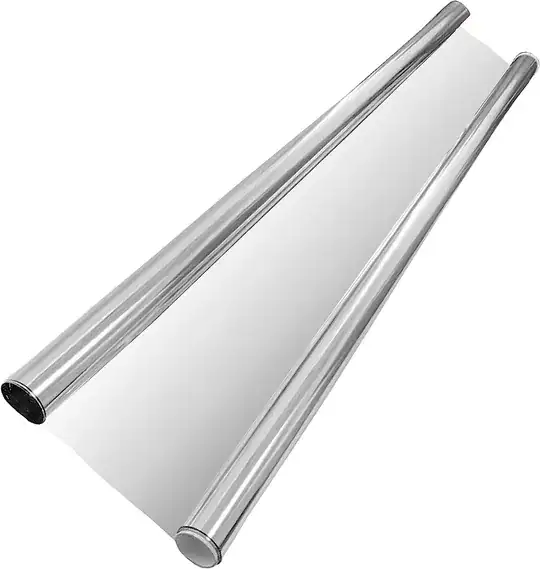

One can purchase silver reflective mylar sheet from various sources (Amazon) at various prices. A 4 foot x 50 foot roll is approximately US$30 with some variation therein. Even an "emergency blanket" made of mylar would serve, although removing the wrinkles may be problematic.
The sheet (or blanket) could be attached on the inside of the roll up using adhesive tape. Mylar is quite thin and would have little impact on the roll thickness.
Note that such an implementation would reflect the sunlight back toward the glass and is likely to heat the air between the shade and the glass. Convection heating will result. It may be less than that experienced by the bare shade, however.

Mylar sheeting
Amazon listed item is source of image, currently out of stock but representative of other similar products suitable for this application.
