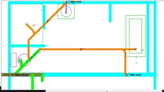

4 fixture bathroom - Florida inspector says all fixtures need to be wet vented in bathroom.
I want to ask if the bathtub to the right with its own vent will work. I believe the inspector is wanting the bathtub on right to also be on a wet vent. If I make the vanity a 3" drain pipe instead of the current 2" and then redirect the 2" bathtub drain pipe to the shared 3" vent of the sink would that be allowed?
Beaty
