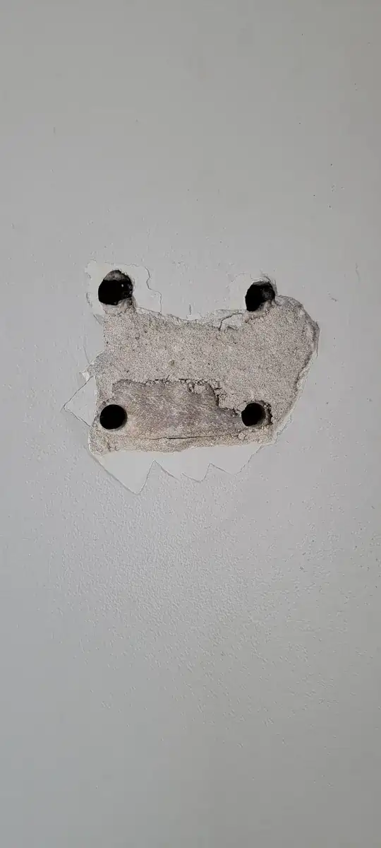

we are new houseowners, and the previous owners left a TV we didn't want so we asked them to remove it and they left this big hole in the wall in the process. We've been looking for a contractor that would patch it up, but nobody will even come up to get a quote because the job is "too small". We figured we might as well see how big of a project it would be to patch it up ourselves, so I have a couple questions there: what would we look up to find some information on how to fix this? The hole is around 4 by 6 inches, is that something we should be good fixing ourselves? What kind of tools/materials would we need to patch it? I can provide more pictures/details if need be, any help is much appreciated!

Assuming you aren't going to be repainting the whole wall, the hardest and most expensive part will be matching the paint colour.
Watch a few YouTube videos about patching drywall.
Meanwhile, in a nutshell, here's what you'll do.
For the hole itself, buy:
  • Non-shrinking spackling.
  • A small drywall spatula.
  • A drywall sanding pad.
Then:
  • Scrape away all the loose paint, plaster, and resulting dust.
    (If you can also peel off a large piece of the existing paint, that will help immensely when matching the colour.)
  • Jam a small piece of wood or cardboard or wadded up drywall tape into each hole, ensuring it is recessed from the surface. It doesn't have to fill the hole; it's to prevent the spackling from falling through.
  • Push spackling into the holes.
  • Spread spackling smoothly over the area, slightly overlapping the good painted area.
  • Wait at least as long as suggested on the spackling package for it to dry.
  • Use the sanding pad to remove the excess spackling, leaving a smooth and even surface.
  • Unless you are even more experienced at this than I am, it won't be even, so repeat the spackling and sanding until it is good enough (it will never be perfect).
You can probably get away without priming for such a small area, but if you have some primer, use it.
Then paint it.
You might get a very close color match, but it will almost certainly still be a visible patch to a certain extent.
You'll be surprised how soon you'll learn not to notice it though. Hanging a picture or other decoration over or near it isn't a bad idea either.
As new homeowners, you'll likely be patching and painting other rooms, if not now then in a couple of years. Your skills will improve with practice. Just don't expect a professional appearance the first few hundred times.
