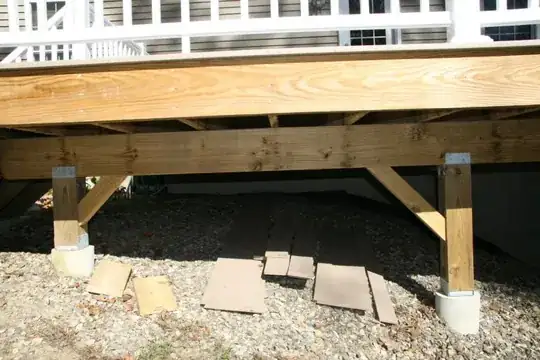

Best practice for wood-post decks is to have the concrete extend above grade and use a stand-off post anchor to hold the wood post to concrete.
Here is an example of this with some knee-braces for lateral bracing. The braces don't match so I find this somewhat ugly, but the image is clear and easy to understand. Footing post cnnection

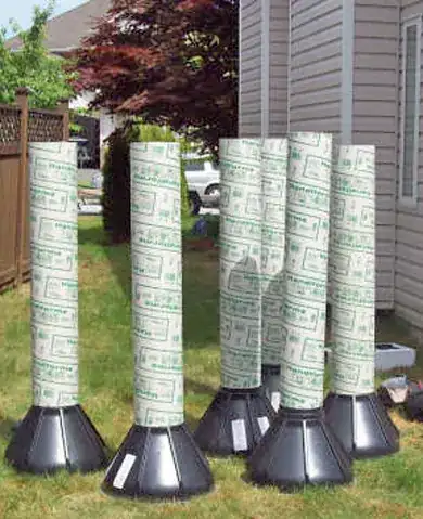

Footings here don't need to be deep so I often form my own square ones but sometimes I use bigfoot forms and I really like those. Although Shirlock's "mushroom" method is more than adequate if you are only required 8" wide.
bigfoot

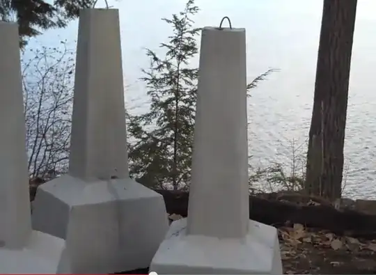

Another neat way is to use a precast pyramid concrete porch post. The concrete post drops into the hole. Seat it firmly, plumb it and backfill. Done. Most of these have a threaded metal insert to accommodate a bolt to hold a metal bracket that secures your wood post. I couldn't find a pic of exactly what you need in your area, but here is a vid of what we use here in Maine on larger projects:
Deck pier video
Smaller versions are available and can be handled by hand, even though a small backhoe is cool to have. A 3 foot post is about 100 pounds 8 inches square at the bottom and 4 inches square at the top with a threaded hole in the center of the top.
