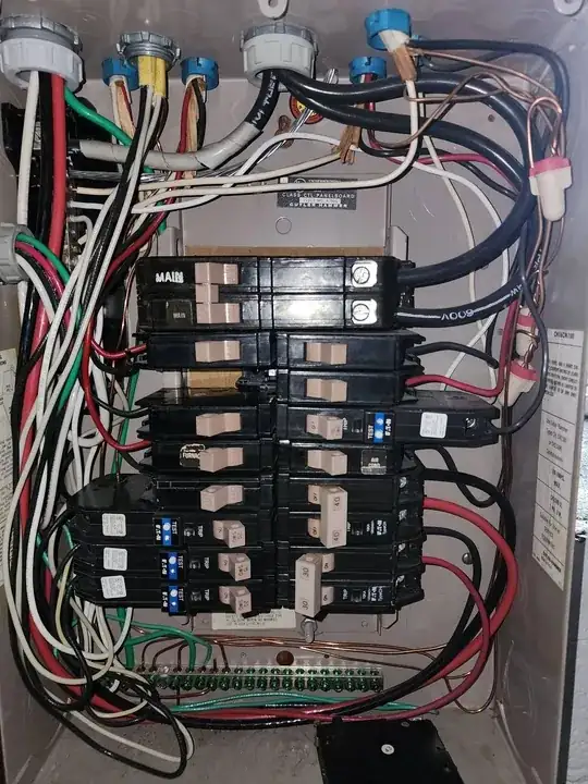

The photo below is where I removed the breaker in question temporarily.
If anyone has any elder wisdom, I'm all ears and grateful.
breaker removed from panel
