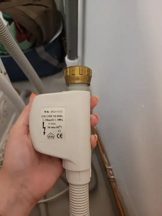

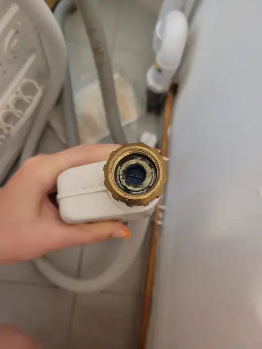

I got an old washing machine From my grandparents but I can't seem to fit the hose into the tap. There are in my opinion 2 problems, there are 2 male connections instead of a female and a male and I think the size is not right. Thanks so much for your help!
The hose to the washing machine: enter image description here
the input washing machine

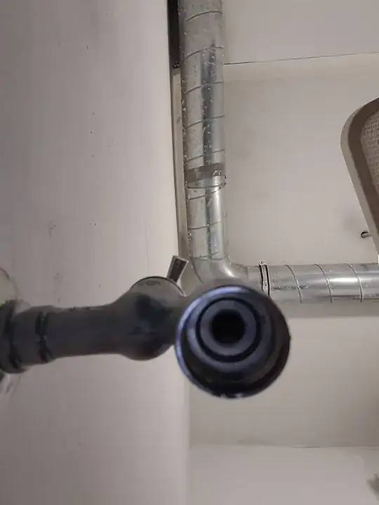

The faucet: enter image description here

A female connection on the outlet side of a tap is unusual. As Journeyman Geek said, a side view of the tap could possibly show that your solution is as simple as removing a female-female fitting to expose a male thread that your washer will connect to.
If it is indeed a female outlet on the tap, make sure there is a gasket in it before you connect a male-male fitting that your washer will connect to.
