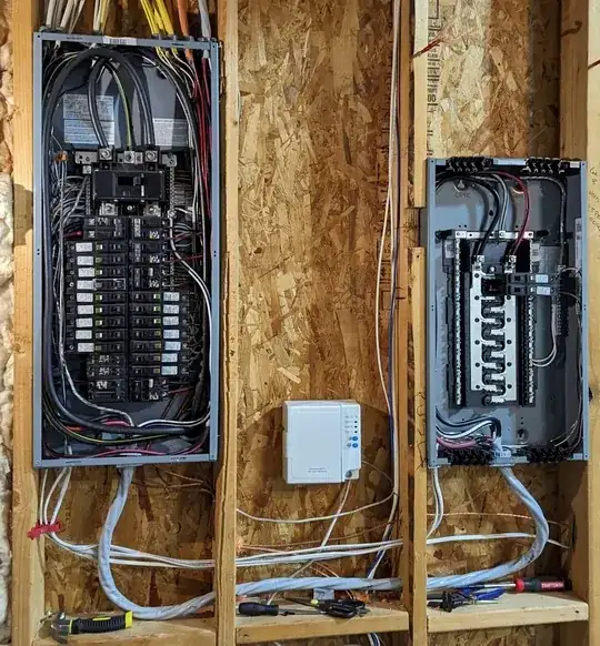

I've just added a 100A subpanel to a house with a 200A main panel, and would like to know if I did everything correctly and up to code before getting it inspected (I'm in WA state USA -- 2020 NEC).
What I installed
photograph of subpanel
It's a Square D HOM2448L125PQGC 125A 24-48 panel with main lugs (but no main breaker). IIUC, you don't need an explicit disconnect (whether main breaker or otherwise) on a subpanel if it's right next to the main panel that feeds it.
Per #3 / #5 THHN and 1-1/4" metal flex conduit for feeding 100A subpanel?, I used 1-1-1-3 AL SER for the feeder.
Wiring the subpanel
I drilled 1 1/4" holes through the studs (1.5" from the edge) for the SER to go to the correct stud bay. This part of the garage is unfinished and it's unlikely that drywall will be added in the future.
I used 1 1/4" knockouts and NM cable clamps + bushings on both panels for the feeder. I didn't staple the SER cable since it wasn't close to any of the vertical studs, but I did tighten the clamps enough to provide strain relief. I used Noalox on the lugs and the tips of the stripped Al conductors before tightening.
Most importantly, I used a torque screwdriver to tighten all lugs to the spec (50 in-lb) per the breaker and bus bars.

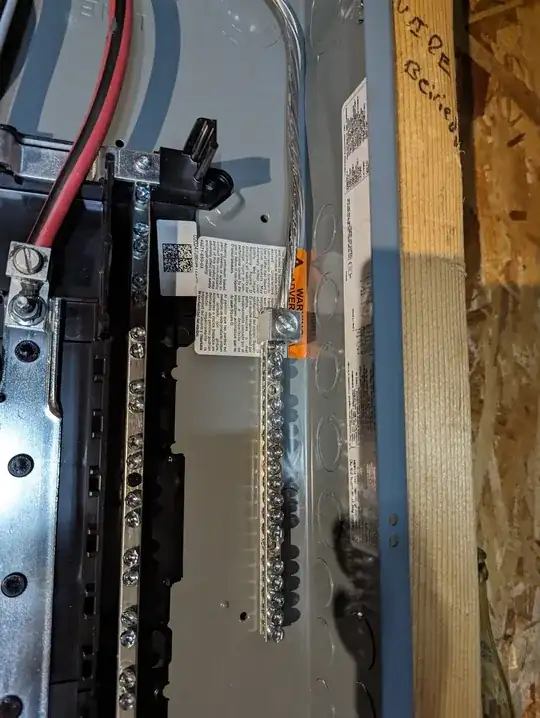

Grounding
I installed one of the provided ground bars on the right of the subpanel. Since this is a subpanel, I didn't attach the screw that bonds the neutral bus to the panel / grounding system.
I didn't install any additional ground rods since it's right next to the main panel, so the subpanel's ground bar is only connected to the main panel's neutral / ground bars (which are bonded there).
subpanel closeup photograph

TLDR: Looks great. The only thing I'm not a fan of is the 100A breaker being directly opposite another large 240V breaker. I understand the temptation to crowd the biggest breakers near the main so they have the least distance to travel on the bus, but buses are overbuilt, and the bigger risk is overloading the thin little bus stabs. If the opposite breaker is 20A I wouldn't worry about it, but larger and I would maybe swap that 240V breaker with two breakers below it.
Now if that breaker to the right is a generator interlock, or a surge suppressor, disregard what I just said - the surge doesn't take any amps (for any amount of time long enough to matter thermally).
IIUC, you don't need an explicit disconnect (whether main breaker or otherwise) on a subpanel if it's right next to the main panel that feeds it.... I used 1-1-1-3 AL SER for the feeder.
Correct... and correct! Common error avoided!
The subpanel wiring looks fine however I'd put a panel over it to provide physical protection.
GOOD! (though this won't be inspected). Make sure you actually checked the spec on each thing (neutral bar, lugs, breaker) as they might differ.
Wait, HOMeline provided accessory ground bars for free?? Must be a counterfeit LOL... no just kidding. That's fine. Yes, either ground bar will carry ground to the other via the panel steel.
