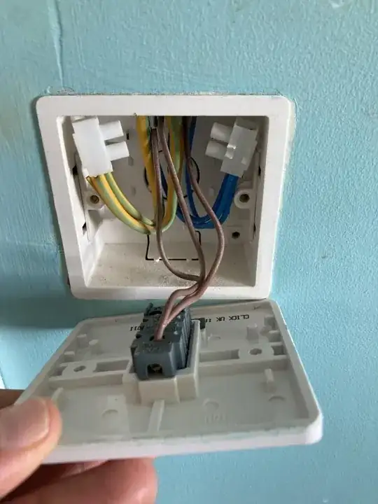

Switch wiring: enter image description here

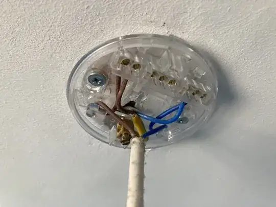

Good light wiring: enter image description here

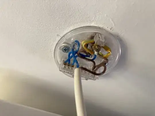

Problem light wiring: enter image description here

Low quality LED bulbs have an irritating tendency to flicker on occasion and sometimes constantly.
While I know of no scientific study to support this, I can tell you from experience that when faced with a the flickering bulb, I have replaced it with a bulb from one of the better reviewed companies.
(One review post is here.)
A better bulb has historically given me better service.
RMDman
  • 52,615
  • 113
-1
The flicker is very unlikely to be related to any wiring.
LEDs don't do well in fully enclosed lamps because they trap heat and make the bulb's complex electronics run hot. Whereas incandescent bulb's simple metal and glass combo don't care about a 30C increase in operating temp caused by lack of ventilation in the lamp housing.
If you must keep that fixture, find an LED bulb line with the highest lumen-to-watt ratio you can find, and then use the lowest wattage you can stand, both of which are efforts to avoid heat, which is what causes internal driver failure (the most common fail method and synonymous with flickering/strobing) and lower-life LED chips.
Larger watt LED bulbs are usually physically larger and have more surface area to dissipate heat, so long is it's not all trapped by the fixture; like a globe for example. Putting such a lamp fixture behind a dimmer, using a larger-watt bulb, and then running it at 50-75% is a good way to run the bulb cooler, reduce flicker, increase efficiency (albeit slightly), and ensure long lifespan.
