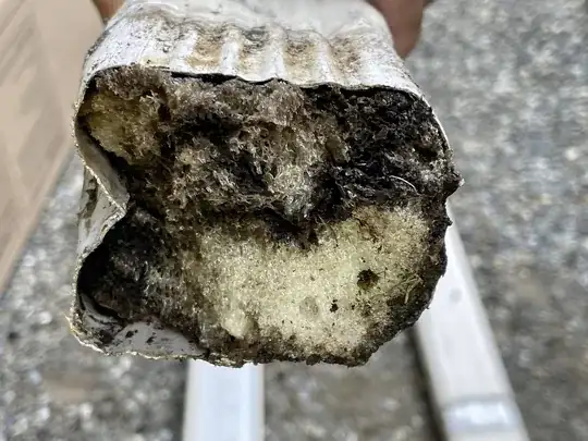

When we had our house's gutters and downspouts replaced a little while ago, the installer discovered that the bottom (end toward the ground) of one of the old downspouts was clogged with the black and white stuff in the pictures, which looks like a mix of dirt and some foam.

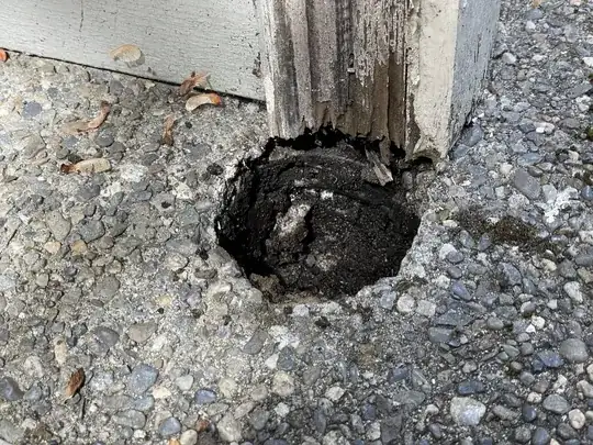

Since the stuff was at the bottom end of the downspout and filled it along with the drain, we decided to temporarily route the downspout onto the patio instead to avoid the water backing up or spilling out of the downspout.
My question: I'm wondering whether or not we should just scrape out this stuff as far as we can and call a plumber to finish unclogging the drain, or whether this stuff has any useful purpose other than stopping up the drainage.

Downspout clogged by brown/black and beige foam-like substance
Drain for downspout also clogged

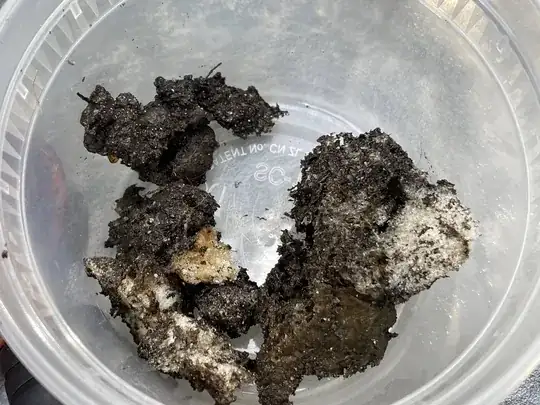

Chunks of the clogging substance
It's a sediment trap. You don't want debris entering your underground pipe where it's much more difficult to remove.
Check the top of the downspout for a mesh or something and resolve the issue there. Leave the sponge in place. Either that or install a modern air gap debris filter mechanism.
As you can see that was a bad idea.
Filtering debris at the end of the downspout will quickly clog it. Using foam is another bad idea. It will break down and clog the underground pipe.
Done by a person who did not want to do the high balancing act of cleaning the gutters, understandable but wrong solution as you can see.
