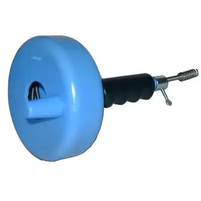

I would skip all the chemicals and just use a drain auger on it to clear the build up. After you break through then you could probably rely on hot water to clean anything remaining out.
Auger
(source: homedepot.ca)

ps. Augers will not work. They will bust up the soap yes but then the pieces will travel further down line and clog again.
