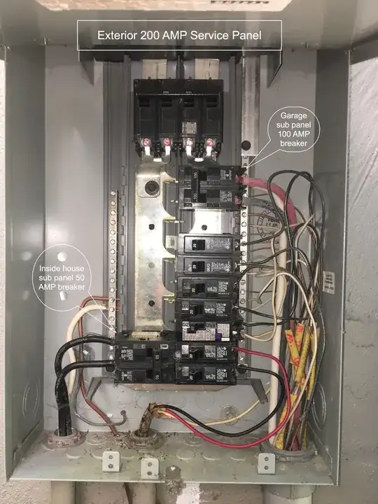

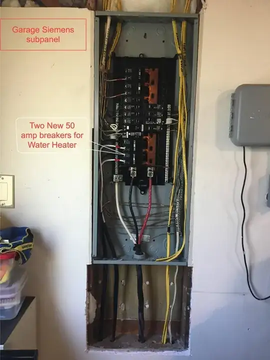

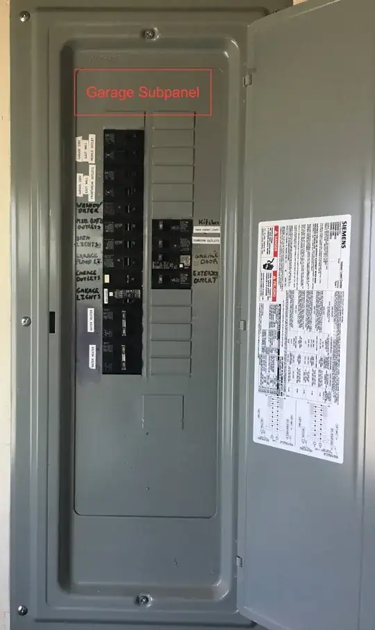

I’m installing a Stiebel Eltron 24kW electric tankless water heater in my garage which requires two 50A breakers and 6/2 wire. I have a 200A sub panel located in the same garage (Siemens G3040L1200CU) and the 200A main service panel (Murray JA220CS Model 4) located about 50 feet away.
I installed the breakers and wiring into the sub panel when I realized the sub panel has a 100A breaker located in the main panel and a #2 copper feeder so is undersized. We have a gas range and furnace so our household electrical requirements are low. I originally had the sub panel installed in the garage so I could easily add outlets for 220V woodworking tools that are used infrequently.

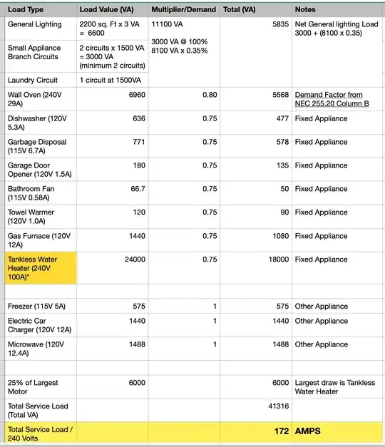

I have added my load calculations and my current plan is use a Siemens ECLK 2225 lug kit at the main panel and replace the existing #2 copper feeder wire with 4 0 Aluminum. Based on this and my newly added load calculations, does anybody see any issues with this?

Load Calculations are mandatory
The procedure that must be used is described in NEC Article 220. Dwellings may use the alternate method in 220.82. The electrician will require this anyway. Note that the electrician may recommend aluminum wire, and that's absolutely fine. Also note that breakers over 125A are quite bulky and expensive, and not available for all panels.
You must do a Load Calculation for the loads which are served out of the subpanel. The Load Calculation, divided by 240, will tell you the minimum ampacity to that subpanel. The feeder wire must be sufficiently large for that ampacity (no Round Up Rule here!)*
Then, you must do a Load Calculation for the entire house inclusive of any subpanels. You must obtain electric service from the utility sufficient for the load to be served.

* The Round Up Rule says that if your required ampacity is less than the wire size, but there isn't a standard breaker size at the wire ampacity, you can "round up" to the next standard breaker. For instance if your calculated load was 102A, and you used #2 copper (115A), you could "round up" to a 125A breaker. To be clear, this does NOT allow putting more than 115A of load on that wire.
