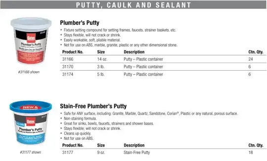

EDIT: I called Oatey to double-check, and they advise against using either regular or stain-free/oil-free putty with ABS.
Their product catalog listing of both products explicitly says "not for use on ABS":

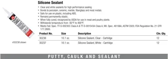

Oatey recommends their silicone sealant for use on ABS:

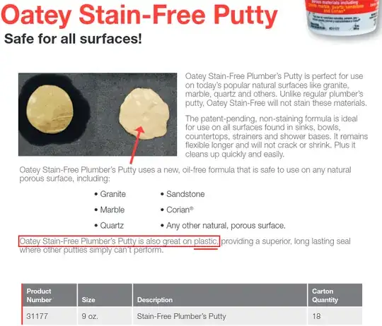

Though the stain-free/oil-free putty product information says "great on plastic".. go figure:
