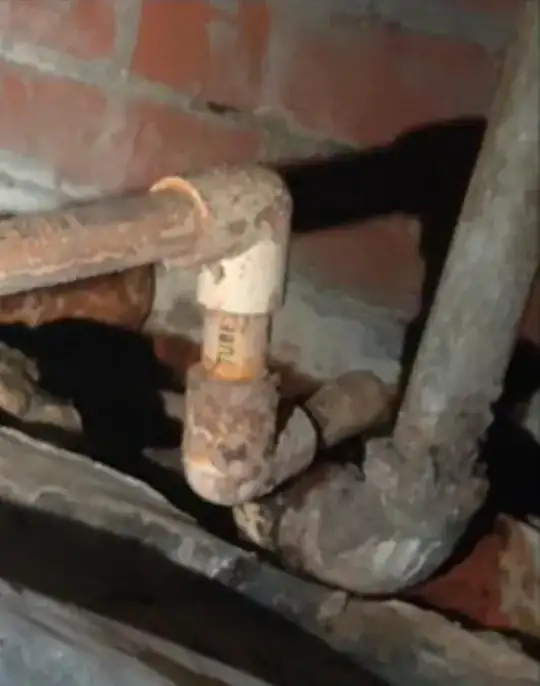

Sorry for the poor image quality. I was installing a water shut off valve for my kitchen sink, and I jostled my hot water line too much while doing the two wrench thing. Apparently pulled the pipe clean off. I didn't realize until I tested my work by turning the water on and heard water flowing in my crawlspace.
Is this an issue of simply reseating the pipe, or do I need to call a plumber? If this is DIY-able I'm comfortable attempting myself but thought I'd ask some more experienced folks instead of just guessing. If it's a reseating issue, do I need any additional supplies (i.e. something to increase the pipe's sturdiness). I'm assuming it was already loose, but I'm not sure if that's just how these connections work.

That looks like CPVC that can be glued. I do not see where the disconnected pipe should be re-attached.
However if both ends ( male and female) are cleaned and dry. Apply the appropriate primer and glue to both pipe and fitting and push together with as much force as you can. Hold for 30 seconds and wipe off any extra glue. Wait about an hour, (or what is recommended on the glue bottle). Then turn the water back on and check for leaks.
