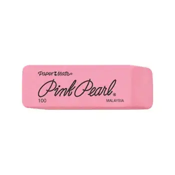

Sometimes, I've had success with an eraser:
It won't damage tile, but results depend on how porous/grippy the tile surface is.
Amazon sells them, so should any local Office Supply or School Supply store.

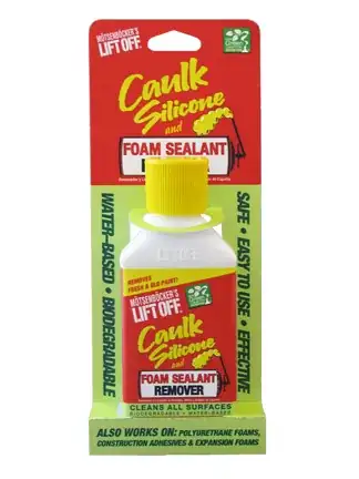

This works on dried silicone and is pretty non-toxic
