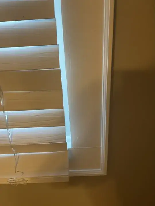

I tested the window sills in our house with the lead detector q-tip swabs, and some came back positive. The top layer of paint everywhere looks very new with no chips or other visible damage. Example of window frame that came back positive

Since the paint on top is new, should I just assume the lead is from elsewhere and leave it alone?
Should I use lead encapsulation paint and paint over everything?
If so, do I need to take further precautions to prevent the spread of dust? Do I need to buy protective gear, an N100, and so on? This happens in some youtube videos, but it's always with chipped lead paint that requires removal as well.
Do I need to call someone else in who's "lead certified" to handle this?
Children don't get lead from mere contact with several layers of modern paint over ancient lead paint. They get lead from paint by the paint peeling and chipping, and then them eating the chips, or gnawing on window sills and the like. There is not another vector for lead poisoning from paint.
