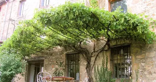

I built something similar to this:
Very easy to make, many options for the structure. Vine grows on it, in the summer leaves block the sun and make shade on the windows ; in the winter the leaves fall off and it lets the sun in.
Only drawback is I have to trim the vegetation once a year.
This is also quite wind proof, due to being full of holes.

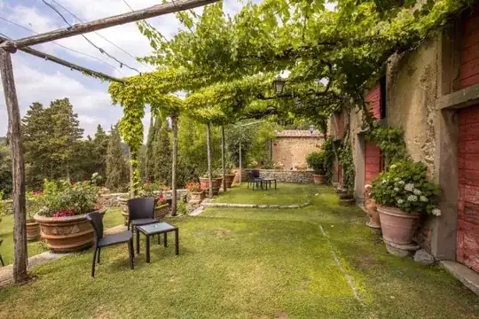

Here's another one:
Basically you need a structure (metal, wood, your choice) either suspended from the wall or resting on feet/columns. Then pull some wire through it, for example every 20cm, to act as support for the plants. You can see the wires in the pic. Choice of plants depends on climate, but the faster they grow, the more trimming you'll have to do.
Wisteria will give flowers in the spring, then shade as leaves grow at the beginning of summer. They will also colonize your roof if you let them.
