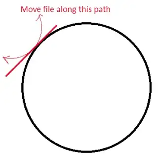

I would cut the circle slightly oversize - e.g. 31 1/16" - and then use a file and sandpaper to get the final shape. Remember to file in the opposite curve to the circle to avoid forming flat spots:
Motion of file on edge
