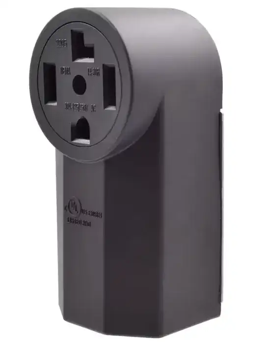

A frame challenge:
Your linked "Carlon" box is a surface mount box. What about replacing both box and insert with a surface-mount 14-30 outlet?
https://www.homedepot.com/p/ELEGRP-30-Amp-125-250V-NEMA-14-30R-Surface-Mount-Power-Outlet-Single-Straight-Blade-Range-Dryer-Outlet-Grounding-Black-2205/317611263
14-30 surface mount outlet
