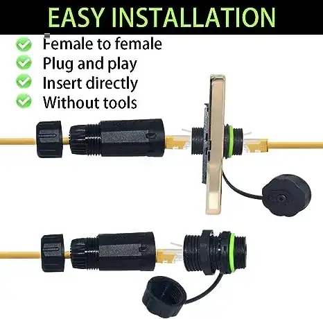

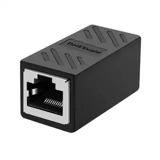

Waterproof ethernet coupler. They are commonly available. Assuming the case (unstated) is that you have a plug, it's a female to female coupler and a water-resistant housing that goes over the coupler, enclosing a short section of the cables leading to the coupler.
You'll also need an exterior-rated (water and sunlight resistant) patch cord.

Extend the wire while indoors with a coupler, and make sure that the section exposed to the outside is weather-proof.
There are also weather-proof couplers available, but obviously at a higher cost:
