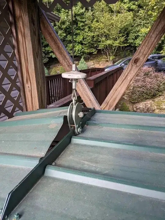

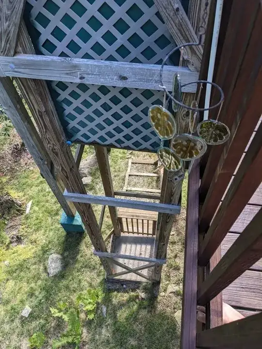

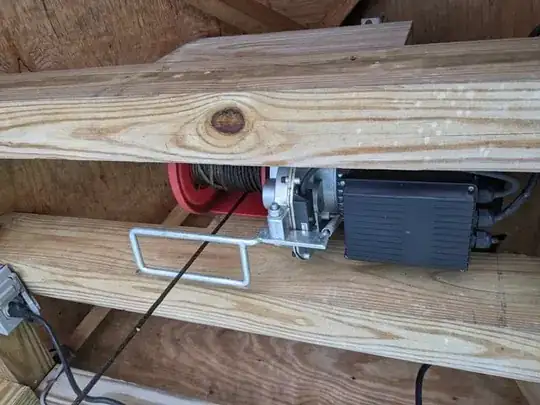

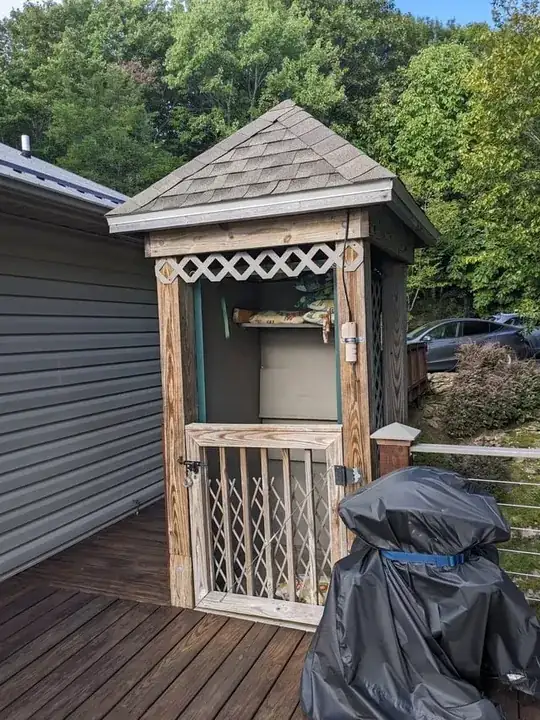

This is probably a situation where a picture is worth a thousand words, so here's a few. The "shaft" is composed of 6x6 timbers at each corner. The "car" is about 3-feet square and is made of metal; little plastic wheels keep it rolling along the timbers. It's suspended by a small electric motor and a length of 1/4" wire rope. The overall floor-to-floor height is 18 feet.

No, it can't. The design presupposes that it is only going to be used for food. It will not be robust enough or safe enough for people. Unsafe meaning, collapsing and falling down or just people poking their fingers and arms where they will snap.
Also, note that in NZ, it would have to be certified by a lift specialist. I suspect this may be true in many parts of the world.
I recommend that you call some companies that make lifts and see if they can fit a solution in the same spot. The cheaper residential lifts are not that expensive, in NZ anyway.

Forget it, this thing is a complete pile of junk.
But don't take my word on it. Ask your insurance company, because I guarantee this thing is news to them.
To qualify as a human-rated elevator it needs to be designed properly from the ground up. And in commercial practicality, that means using an off-the-shelf pre-engineered design, because that is far cheaper than a civil engineer designing an elevator from scratch. It would be impossible to build an elevator shaft out of 6x6 and have it be safety rated. Using a winch as a lifting mechanism (and braking mechanism!!!) is also a non-starter
This was a foolish hack design done by the previous homeowner behind the back of his insurance company. They represented it as a dumbwaiter for cargo only, even though it's obviously built for humans, for liability reasons.
There will be no way to adapt this into a legal elevator. For your own liability's sake you should either demolish the whole thing, or redesign the car to be 2 feet tall to preclude use by humans, so it truly is a dumbwaiter.

My big worry is that the elevator car sticks and slips somewhere. It gets caught on the platform, the cable spools a little, and it drops a little way. The winch that is fine under just a standard load suddenly has the job of bringing an elevator car to a near instantaneous stop.
This is generally something you want to avoid doing in physics. It exposes every bit of the system to a multiple of the regular force on it. None of this system looks designed to handle multiple times the regular weight of the elevator + passenger.
