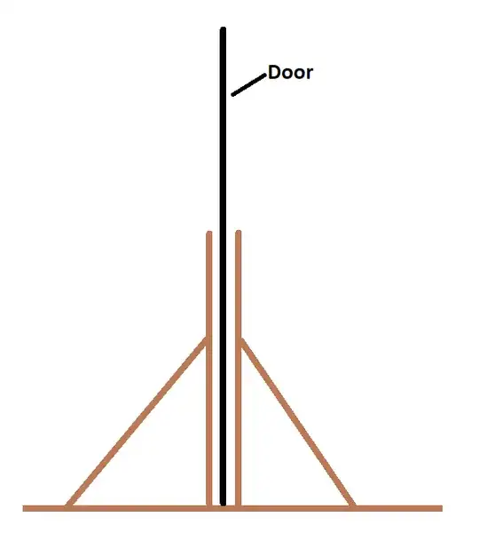

If you have several of these doors then you could fashion some sort of wide-stanced brace to prevent the door from falling forward or backwards while you do your work. Make the bottom plate thin enough to go under all of your doors and shim for the ones further off the ground.

  2. Build a simple jig that fits around and under the door. You would slide this into the open door and it would support it from tipping or drooping. I imagine something similar to a bike rack where the tire is supported
