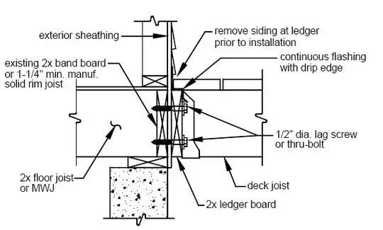

Back to the ledger... There should be flashing over the ledger (and under above siding) to prevent water from entering your house. Also your siding should be tight to deck and caulked. See the flashing picture below.
They can pull the interior deck boards and add the flashing - make sure they do the edges too because taking down the railings on each side will be some work for them. I am not really sure about the quality of the install if they missed this though. I am not a "deck" expert and this is just common sense. Also you saying the ledger is attached to 2x4s makes me wonder. Not saying that your deck was installed wrong other than the flashing but pictures and more info would help.

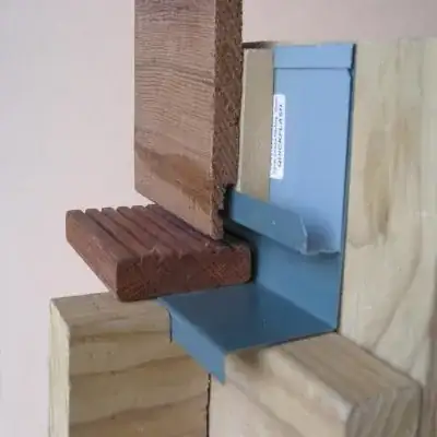

Edit - There is a way to add flashing when you forgot. See picture below for an example.
You see how this has to be notched into the joists. Because the flashing is usually under the joists. Personally I would call the city and make sure this doesn't pass inspection. Usually there is flashing completely under the ledger, above the ledger, under the joists attached to the ledger... At first I was thinking about retrofitting flashing but thinking about it more makes me think this is a tear down. You paid for this deck to be done right and no matter what - unless they pretty much take everything down minus posts - it isn't really right.

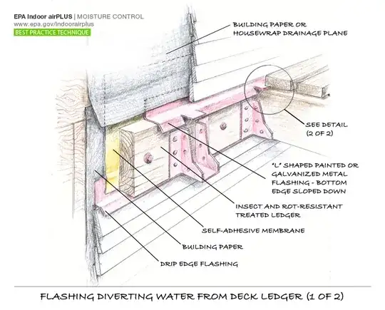

You should have flashing every time you have a change or intersection of structure or material. The flashing should be lapped with building paper.
See Image for an example of proper flashing.
The siding should not be caulked to the deck, in most cases you should leave at least 1/4" between the siding and the deck boards (but always check siding manufacturer's installation guidelines.)
Ledger Flashing
The ledger board is generally installed after sheathing. However, the ledger being over top of sheathing or not should make no difference in water penetration and is up to the structural engineer or local building codes and should be fine if it passed inspection.
Your flashing and cladding details are what will either cause or prevent leaks.
Also, if you have any details that rely on caulking to stop water infiltration, you have a future leak waiting to happen.
