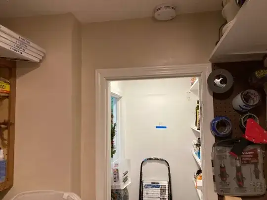

I have a wall that I’m confident it is not load bearing, but I thought to put it out there to see if someone thinks I’m incorrect. Here is what I know and can see:
  1. The wall length is little less than six feet. It is sandwiched into an existing laundry room dividing it in half. The wall runs perpendicular to the joists above.

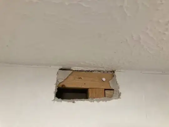

enter image description here 3. So since most walls perpendicular to joists are load bearing I go to the next test: cutting out the top portion of the wall to see the top plate. I see a single plate and not a double top plate.

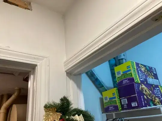

enter image description here 4. It does have framing of a closet 90 degrees to it, but that wall is parallel to the joist so going to assume it’s not load bearing.
So I’m confident this wall is not load bearing because of the following:
  1. Top plate is a single and not a double
  2. Wall looks to be simple framing for a door and a closet.
  3. Wall is very close to the exterior load bearing wall and wouldn’t expect to handle any weight
  4. While the joists above are perpendicular, the joists above are not double stacked on top of this wall.
