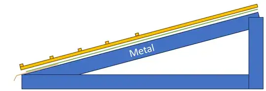

Here is a diagram of what I'd like to be achieved for the structure:
Metal rafters, wood sheathing, vapor permeable film
