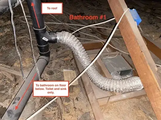

Bathroom #1: -Has an older nutone fan that seems a little weak, and I was thinking of doing the Panasonic Whisper choice DC Pick-a-Flow. https://www.homedepot.com/p/Panasonic-Whisper-Choice-DC-Pick-A-Flow-80-110-CFM-Ceiling-Bathroom-Exhaust-Fan-with-Flex-Z-Fast-Bracket-RG-C811A/320520625. Would this work? There's so many panasonic options to pick from... -I have questions about the existing ducting. Currently, it's going into a flex silver duct and then a black ABS T-piece. (the ABS from the floor below is a powder room only; no humidity). It terminates through the roof. Is this going to be a problem or something I should rectify? I'm not sure I have the skills to put in a new roof vent. Also, I don't want humidity being pumped into the downstairs powder room....

First- is that black ABS the vent stack? That is, is it hooked to your toilet and sink drains? If so, DO NOT use that for the fan's exhaust. It's against code, and possibly lethal with sewer gas coming back into the house. Even with the fan's "flapper" that is supposed to prevent backdrafts, they're not perfect and negative pressure in the house will cause sewer gas and smell to come into the living space.
The fan needs to be vented on its own duct/pipe, out the roof or out the soffit if possible. Going out the soffit avoids a roof penetration, which is almost always more desirable.
And yes, it needs to go out. I've seen people just duct their bath fan to the attic. If you live in a place with climate (cold and hot), it's a recipe for mold and rotting out your roof sheeting. Even if the bathroom is "low humidity", you're still pulling air from the rest of your house. In the winter, that warm air hits the cold attic and moisture condenses everywhere.
