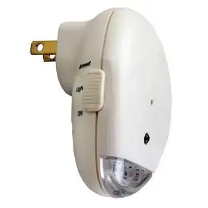

To make it more obvious, you could plug a nightlight into this outlet.
Even better, plug in an "emergency rechargeable flashlight": the kind that plug into the wall, but turn on automatically when you unplug them or the power goes out.
This would more readily draw attention: if the light is on, there is a problem.

If the ground-fault protection was provided by a GFCI breaker, you could plug a power outage alarm into the sump receptacle. If the GFCI breaker trips, the alarm will sound, and the homeowners will know they have to reset the breaker.
Power outage alarm
