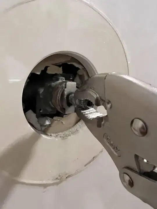

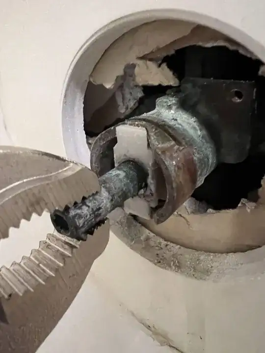

Here's a few pics to give you a sense of the equipment I'm working with:
Shower Valve Left Side Shower Valve Right Side

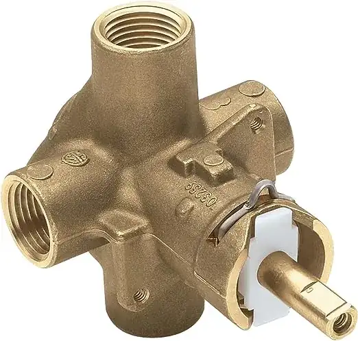

I can't know for sure, but I think I have a Moen 2510 Four Port Cycle Valve like the one in the picture below:
Moen 2510
