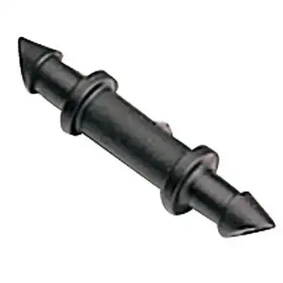

The barbed coupler I'm talking about looks like this (am I using the wrong part?):
Barbed coupler

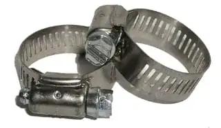

Usually you use a stainless steel clamp around the connections:

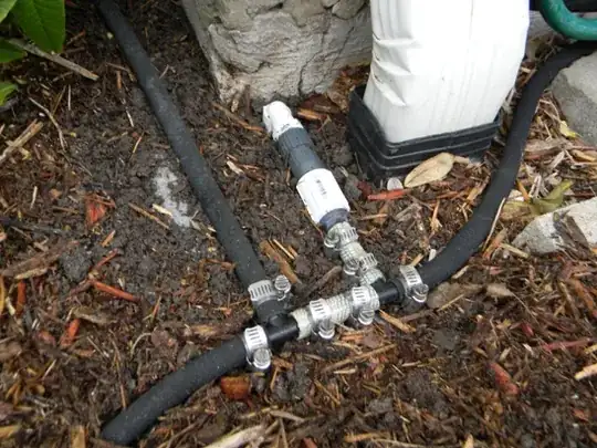

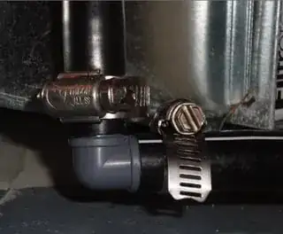

Here's a finished connection (using "white stripe" 75psi poly - in this case as a non-pressurized drain line):
Here's another example showing connections to soaker hoses:
