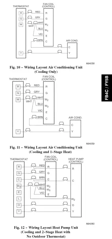

As an example, on your furnace, from the manual:
The colors may match, but don't count on it. The sure-fire way is to check using a multi-meter as I said above.

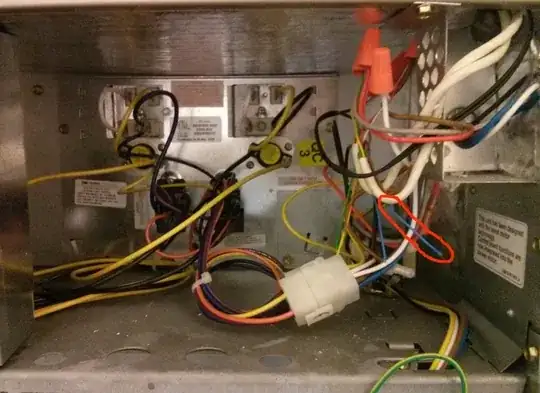

After exhausting every possibility for a failing common I found a splice of old wire and new wire where the air handler was swapped out but not the thermostat. After connecting the thermostat common (blue) to the brown common in the air handler it still wouldn't work. I had to trace the wire until I found the splice and was able to tie the common together at that point. After that I had no problem.
