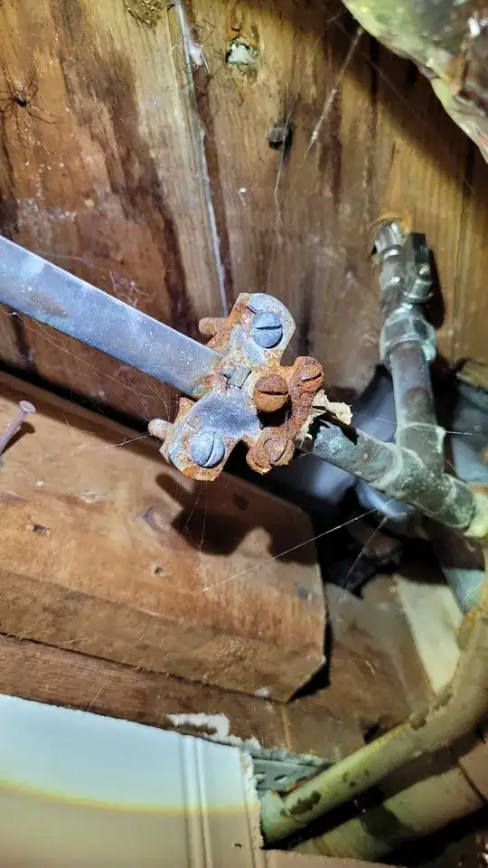

During the pre-purchase inspection I was told that a saddle valve in the basement would inevitably pop open and leak and that we should get rid of it as soon as possible. Now might be a good time as I have other plumbing work planned.
Here is a picture of the saddle valve:

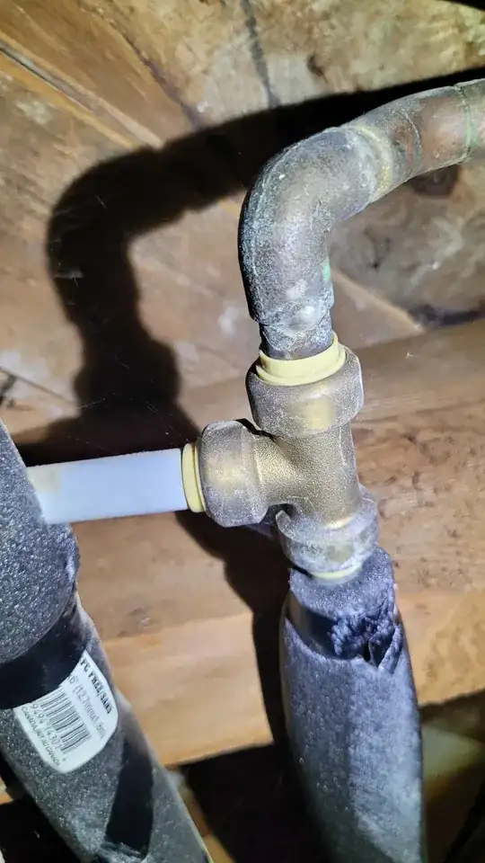

I have soldering equipment in the house, but have never done any soldering other than for electronic components. I don't really want to set the house on fire, so I was thinking maybe of using a sharkbite, there is a sharkbite already used on the same pipe further down:

Is sharkbite the way to go? Should they be used sparingly?

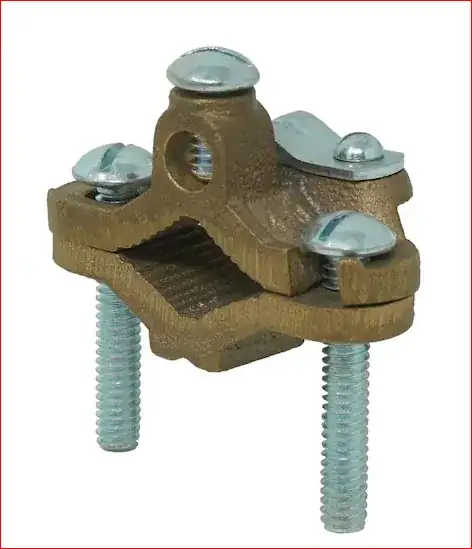

That is not a saddle valve, it is a grounding clamp. You can even see the tip of the old wire still sticking out from under the screw clamp.

Aside that what you are shoving is not saddle valve but a grounding clap, here are some tips how to cut a pipe.
Using a tube cutter is old way, but cleaner than angle grinder.
It will give you a clean cut and perfectly perpendicular to the tube.
The shark bite is somewhat sensitive to uneven tube cut.
Using the angle grinder is fastest way but requires skills to make a perfectly perpendicular cut. It also leaves lots of residue even inside the pipe which you must clean up, otherwise it will get stuck in the valves. With that said, I use angle grinder, but put a mark on the pipe as guide. For that I use masking tape and wound two around the pipe leaving a small spacing between them to act as my guide.
