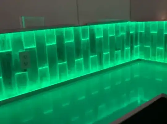

There exist clear grouts for tile. You might consider using that (expensive) stuff and illuminating things from the edges. I remember Sal DiBlasi made a video implementing the concept. There it is: https://www.youtube.com/watch?v=tn0R3Zius98.
