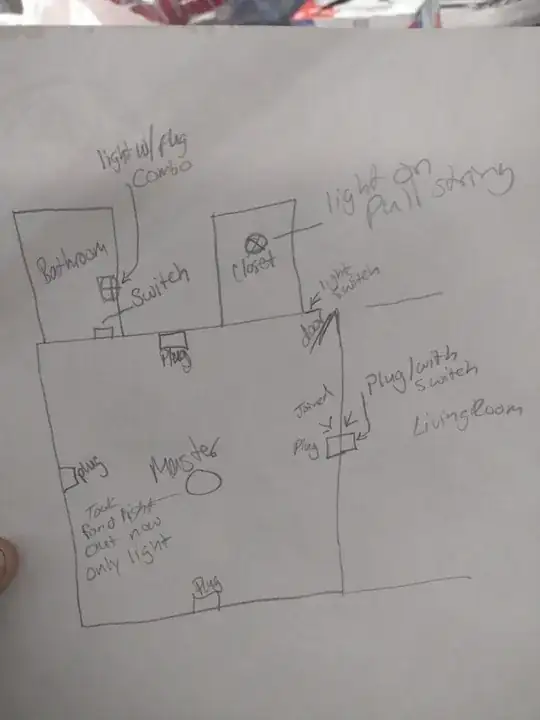

The power to my master bedroom stopped working. I changed my light fixture first from a ceiling fan/light combo, I'm getting power in room from what volt meter says. I have also changed outlets out to three prong from the old 2 prongs. This house was built in 69 and never been rewired.
What I need to know is what my wiring should look like on first outlet in room that also joined by the outlet in my living room.
It should look exactly like you found it.
And, if "tabs" were broken off on the old receptacle, they need to be broken off on the new receptacle also. Failing to do so will either make light switches no longer work; or make a big spark and trip breaker(s).
If things simply stopped working, then look closely at the neutral wires (white, though not all whites are neutral) and make sure neutrals are exactly as you found them.
