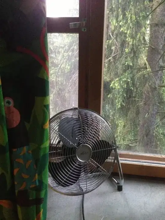

This is a campus building in Aalto University where you have a tree about 10 cm away from the window. The Espoo city does not allow the student organisation AYY to cut down the tree. There is a poor air-conditioning in the room so the fan is essential to speed up the airflow. Without the fan, the window becomes smoky and the room very hot.
I need to find filter to the window so I can keep the fan on also during times of heavy pollen times (15x100cm for the above window). The filter must be sturdy because birds get into the room.

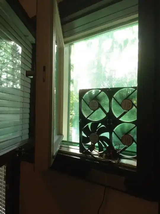

I tested a novel idea of using computer fans with polycarbonate plastic thing for a smaller window but the computer fans provide very small airflow in comparison to the large fan.

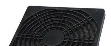

Which kind of filters should I use in windows like above? Is it enough to have a cloth pinned to the sides of the window? Or do I need carbon filter? Can I use filters meant for computer fans like the above?

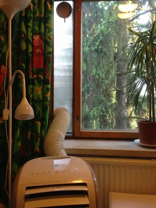

Get an air-conditioning system. I got it because my room has no output air channel so adding an extra output air-channel through the air-conditioning system fixed the problem of smoky windows. It filters the air and it is pretty easy to install: it takes air 1 block inside and 1 block moving outside so the pipe just to the window for the output channel.
The downside of air-conditioning system is the energy consumption. Smallest/cheapest unit I could find was 250EUR "ilmastointilaite" unit from Bauhaus with 2k W/h energy consumption (only one offering 5 years' warranty hence chose this model) so it costs about 15 cents in Finland to run one hour with the full mode but 15 minutes running does very good job in cleaning the air and making the room comfortable to sleep and work. So it is relatively cheap to filter the air unless much higher electricity prices and/or far larger/higher apartment.
I don't like to sleep with it on because of the noise. So I created an output air channel to the top of the window in PMMA plastic ("kelmumuovi") and the hot output channel to the bottom for the machine when it is operating: this means that the room air will go from the top when the machine is not on and when it is on the air will go away from the below hole. This saves energy and keeps the cold air inside the room and hot air outside because the special PMMA has air between the plastic strengthening and air is an excellent insulator.
