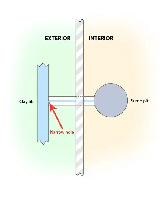

The den does have a sump pump. The sump pit is fed by a clay pipe which is about 5 feet underground. I called a plumber who fed a video camera into the sump pit to see if there was a blockage in the clay pipe. He immediately ran into a problem:
Clay tile with inadequate drainage
Basically, the clay pipe that is outside and the clay pipe that leads to the sump pit form a "T," and the outside pipe has a tiny hole that the plumber claims is inadequate to drain the outside water. Additionally, this narrow hole prevented us from using the camera to see if the clay pipes extended all the way around the den.
The plumber says that this could be causing the standing water that I see under the vents, and that the solution would be to dig outside down to the exterior pipe to widen that narrow hole. This solution doesn't sound so bad.

My bottom line would be that you want to do anything you have to in order to get the standing water out of there. That may very well require some work to redesign the outside drainage lines. I'd look into an outside drainage system that fed into a nice deep rock filled pit that allowed excess water to disperse into the ground away from your house foundation. You may also want to equip that outside pit (also known as deep french drain) with a sump pump to take care of extreme heavy rain or high water table incidents. After the drain situation is corrected I would look strongly at correcting the landscaping and roof runoff gutters to you minimize the amount of water that the drain pit is asked to handle.
All that work can be done outside without tearing up your floor in the den. Hopefully the area under the floor would then stay dry like it should.

I basically agree with your plumber, expose the pipe and repair. This is the simplest and most direct solution. I think your duct wetness is a symptom of the water not draining to sump and getting under the slab, and thence into your ducts. As Mr. Karas suggests, keeping rain runoff and ground water away from the house will lessen the load on the sump.
Lowering your sump pit might be an option to discuss with the plumber, to be done at the same time.
The other solutions are valid, if costly. I can also suggest a 4th solution (with no personal experience) once the water issues are corrected.. Duct relining in place. They claim to seal out any existing mold.
Caution: if you do the excavation, don't go deeper than 3 feet by yourself (as in, not alone). Don't go deeper that 4 feet without adequate shoring ( horizontal timbers and a shield wall). Wet dirt collapses without warning. OHSA requirements for excavations
