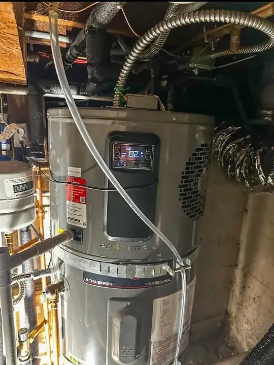

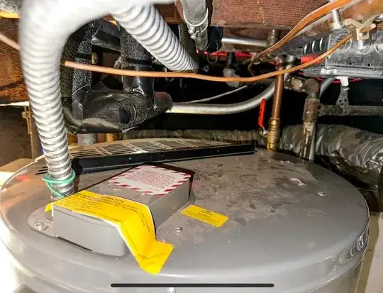

I got a new heat pump water heater installed. Unfortunately my installer should have never ever gotten a license. Among many “crimes” that he committed I only afterwards found out that I cannot even replace the filter how he installed it:
The black plastic bar on top of the heater is the filter which is supposed to be pulled out straight upwards. Unfortunately you can see that there is an insulated pipe (hard to see because it’s black) in the way.
I cannot manage to pull it out beyond a few cm.
The only option I see is to rotate the whole tank. But then the exhaust is more blocked. Also this tank is so heavy that I do not know how I would even rotate it.
How to I replace the filter?

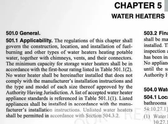

You're probably governed by the Uniform Plumbing Code (UPC). My municipality has a website that lists my codes, but it could be your county or even state. Verify that your plumber is governed by the UPC.
Note the "No water heater shall be hereinafter installed that does not comply with the manufacturer's installation instructions" from 501.1 of the 2021 UPC:

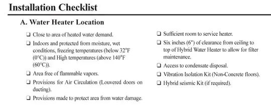

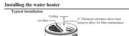

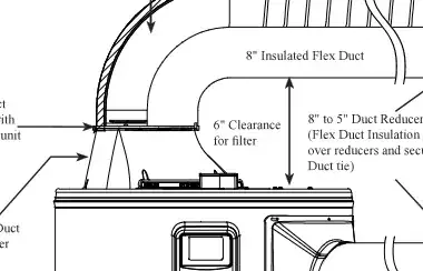

So now you need to find your water heater's installation instructions and verify that they prescribe a clear space above the filter to facilitate access. I'm pretty sure that I found your tank or at least a close analogue:
and
and
Your contractor has some wiggle room because of the common use of the word "ceiling," but the "6 [inch] Clearance for filter" and "sufficient room to service heater" look to favor you in my opinion.

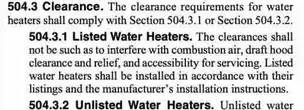

More directly from the UPC alone:
UPC 504.3.1
Note the "accessibility for servicing."
Now that you're well informed that your plumber has installed your water heater out of compliance with the plumbing code, you need to call him back to bring his work into compliance. Use your manners, because I suspect that hardball involves damaging yourself with a call to your city to give yourself a legal claim against the contractor. Unless you haven't paid him yet. If you haven't paid him yet, then rest easy (and don't pay him until he gets it right).
