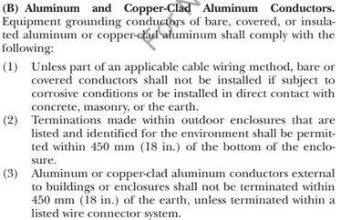

Assuming you are in the US, the National Electric Code (NEC) allows bare aluminum equipment grounds and grounding electrode conductors.
For equipment grounding the relevant section is NEC 250.120, which prescribes corrosion protection for bare, covered, or insulated aluminum or copper-clad aluminum:
NEC 250.120(B)

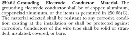

For grounding electrode conductors, NEC 250.62 explicitly allows bare aluminum grounding electrode conductors:
NEC 250.62

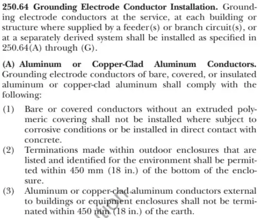

with NEC 250.64 prescribing corrosion protection that doesn't differentiate insulated ground wire from uninsulated ground wire:
NEC 250.64
