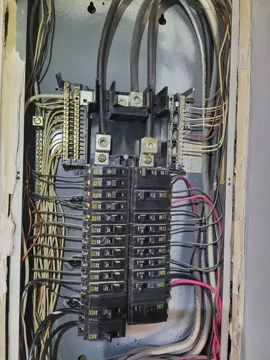

Does this electrical panel look wired correctly?
An electrician is telling me I have to move the bare wires and it doesn't look like that's the case in the code. I just want to make sure on my picture below.
The electrician is correct about that. You have shown us a picture of a sub-panel with a four-wire (hot/hot/neutral/ground) feed. There is no main breaker in this panel. There is a main breaker somewhere else, and neutral and ground are bonded together there. In this panel, neutral wires and ground wires must be kept strictly separate - neutral wires to either of the two bars just above the breakers fed by the insulated neutral wire, grounds to the ground bar on the far left fed by the bare ground wire.
You have made a very dangerous error: if the neutral between the main breaker and this panel somehow gets disconnected, all the grounds that you've connected to the neutral bar will be hot and someone could be killed by touching a grounded metal appliance casing (and no downstream GFCI could save them because GFCIs only monitor and interrupt hots and neutral - not ground). In the case of that kind of failure, everything that should be perfectly safe (grounded) becomes deadly.
