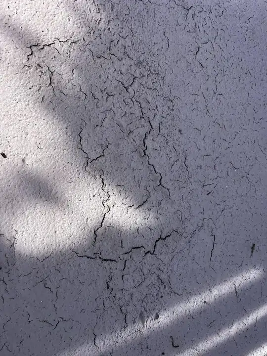

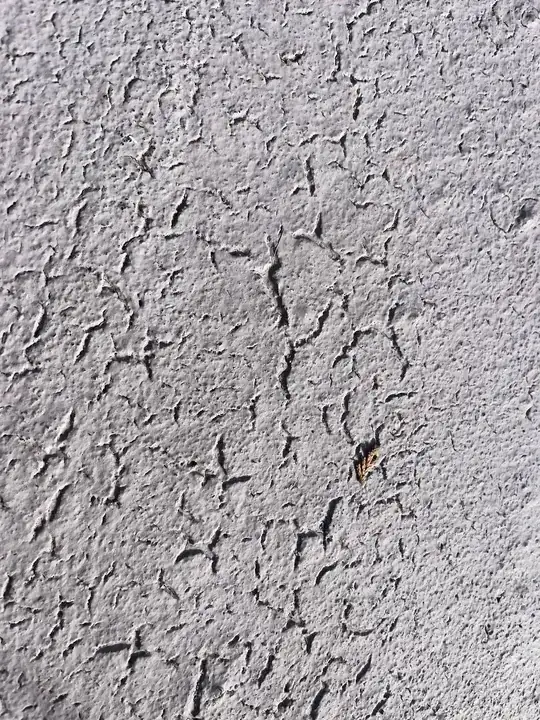

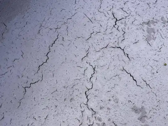

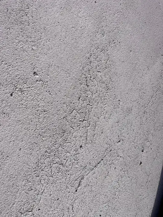

Here are a few pictures of the cracking. This is a rubber type patio coating that we walk on. Not a roof. Though it is over our garage so it's a roof deck.

How big is the deck? I've had torch on applied to wet plywood. Torch on roofing lasts 35+ years and is a walkable surface. It doesn't look as good as vinyl so people typically put composite or concrete pavers overtop. Vinyl typically only has a 5 year warranty which seems ridiculously short for something over a living space.
As far as sealing a cracked vinyl membrane there are products they just can't be bituminous. Liquid rubber seems like one product that can be applied over a vinyl deck. Seems like you could just buy a tube of their sealant and give it a try - low cost to tide you over.
