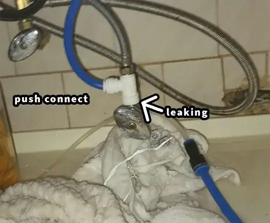

I was using the plastic connection that came with it:
Connected like so: enter image description here
The top connects to my faucet (plastic male to female connection), and the blue plastic hose push connects to the KOHLER water filter which connects to my fridge's water line
The fitting is leaking where it threads into the water valve (plastic female to male connection). I took the fitting to lowes/home depot and tried to attach it to newer valves but it would always spin in place when trying to connect. I suppose the threads got damaged.

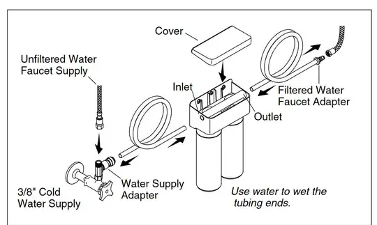

In the photographs of the water filter I noticed they used an adapter as well:

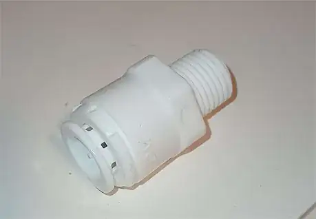

The closest thing I could find in lowes was a male to push adapter: enter image description here

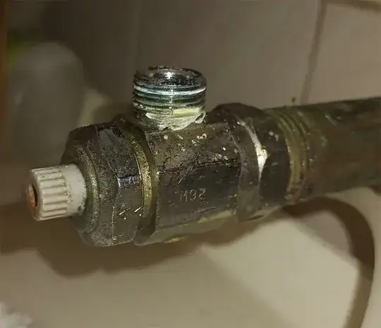

This is my water valve after some disconnections: enter image description here
I am pretty sure its 3/4 inch for all connections (this may be incorrect according to manual stating 3/8 inch water supply connection.

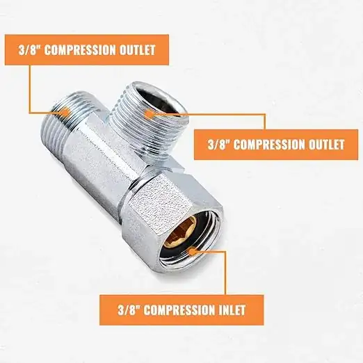

I solved it using an adapter tee: enter image description here

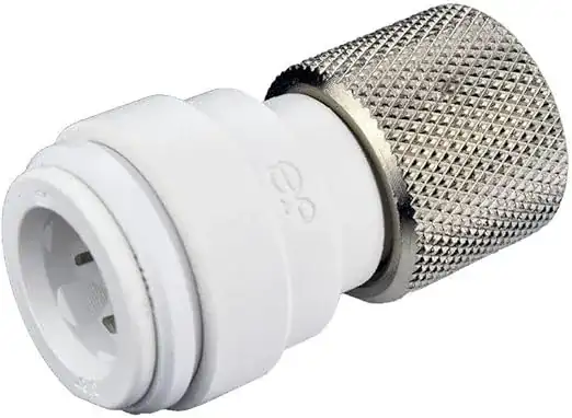

and a 3/8 Inch Compression Female Connector to Push to Connect enter image description here
