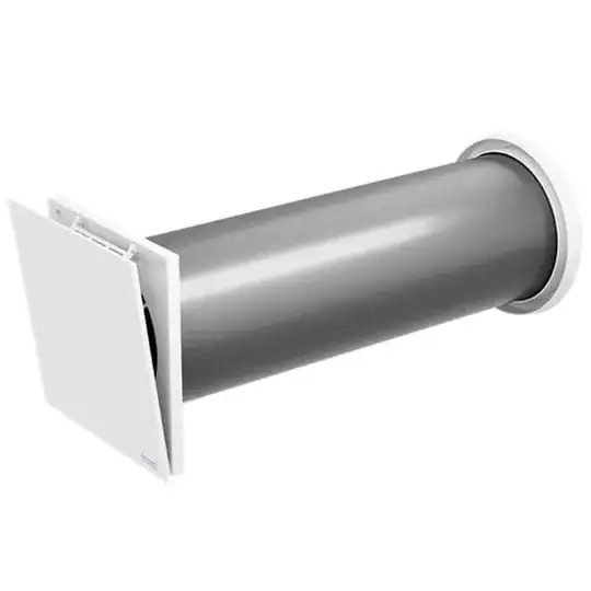

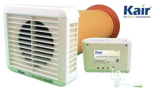

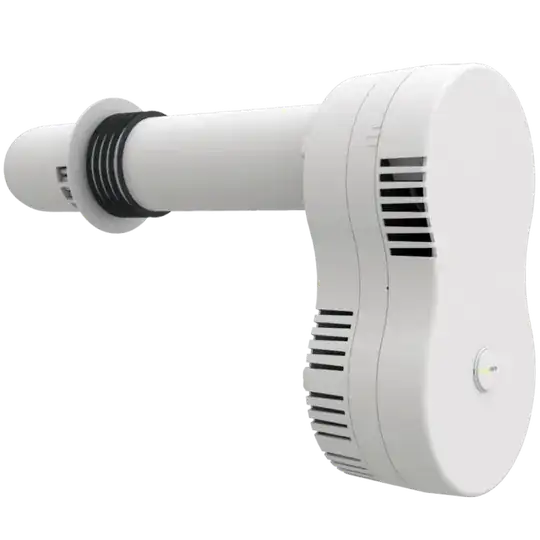

There are single room MVHR units, also called Decentralised MVHR (dMVHR). They give you a continuous supply of fresh outdoor air while retaining heat from the indoor air that they're pumping out. They can often replace an extractor fan with a single hole in the wall, but add heat exchange too. They usually operate in a trickle mode for a continuous low volume of air exchange, but some can boost if humidity goes up - for showering or cooking.
Typically they either use concentric pipes (stale warm air goes out, transfers heat to fresh cold air coming in the adjacent pipe) or a counter-flow design with a heat-absorbent material (stale warm air blown out, warming up material, switch direction, fresh cold air pulled in, takes heat from material) where the flow direction changes about once a minute.
The advantage of a dMVHR system is there's no central unit and ducting, you can just install these in holes in the walls, as many units as you need. I'm not sure how they compare with a whole-house MVHR in terms of efficiency, but note that efficiencies of ~80% are quoted: that means 20% of heat from extracted air will be lost (since they are in effect a big unobstructed wall opening), and they can cause draughts especially if the wind blows through them (check baffle arrangements, and maybe there's a way to close them when it's freezing outside?)
Some examples:
Envirovent HeatSava HeatSava
Vent Axia LoCarbon HeatSave or Tempra Vent Axia LoCarbon HeatSave
Kair HRV150 Kair HRV150
