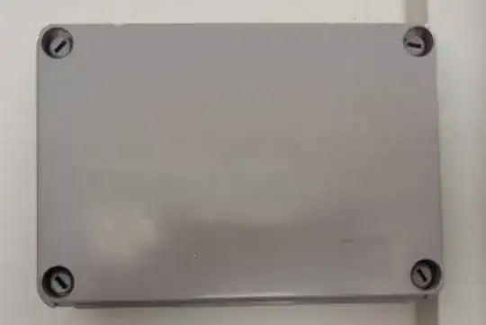

My new apartment comes with TV outputs ... which are mostly useless in the era of DTV and with our national cable networks being decommissioned. They're connected to a splitter that's connected to... I'm not actually sure what
According to the schematics, thesplitter is in this box, and I can't really see anything going in, other than the trunking. I might have use for MOCA for these, since the ethernet connections terminate there too.
I tried to open it with an (admittedly too small) screwdriver and munged up one of the plastic bolts a little. I'm wondering if there's a 'proper' tool for this - and what its called

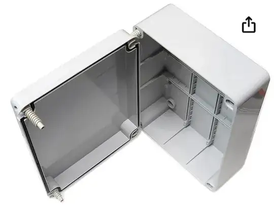

just use a larger screwdriver.
with two of the screws fully out and the other two half undone the lid will hinge open
image credit amazon.
But, as some bozo has mounted it sideways, you may as well undo all the screws
