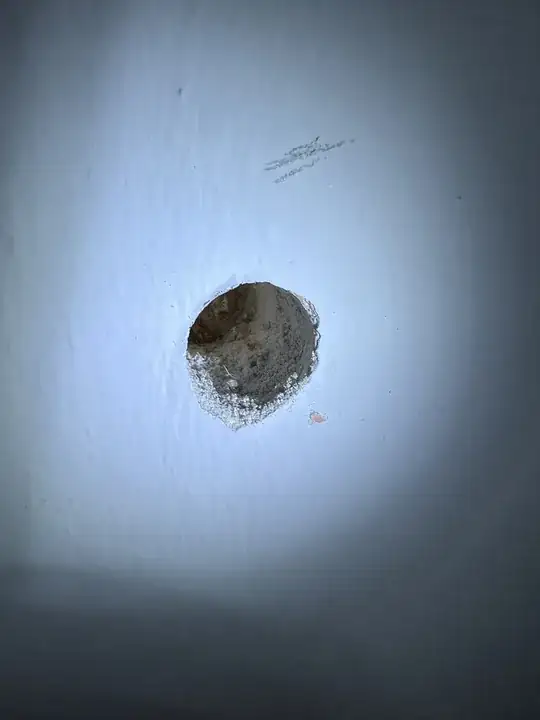

The stud is 1 inch behind the surface of the wall (lighting is poor here, used a flashlight to help):
hole drilled into wall, 1 inch to stud

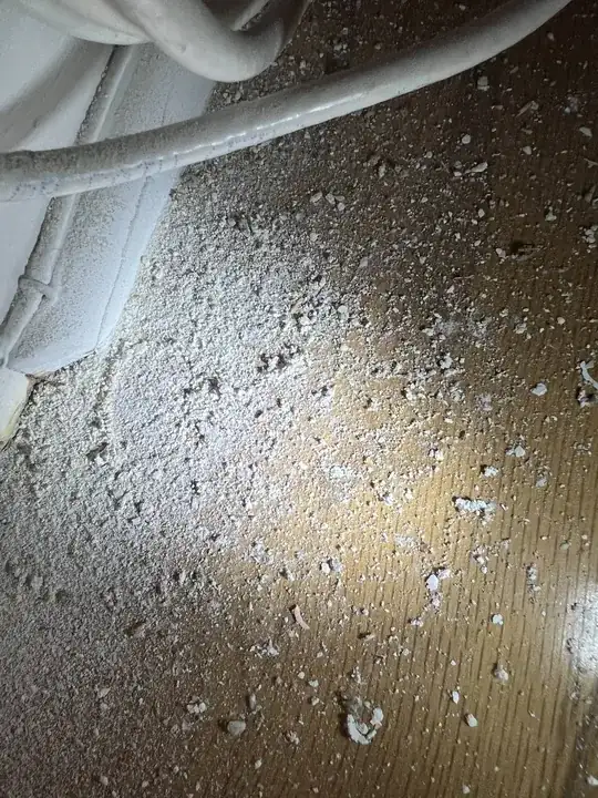

and here is what the debris from drilling into the wall looks like:
debris from wall from drilling, on floor
Can you have plaster this thick without the wooden lath material to support it? Or if this appears to be drywall, was this a more common thickness back then (I know 1/2 inch and 5/8 inch are common now in the US)?

Hard to tell from the pictures, but it could be rock lath plaster. It ends up looking like someone put coarse plaster over a gypsum board then finished with fine plaster, which is basically what it is. No wood or metal backing.
I know it was around in the 50s and in the northeast. It's basically applying plaster over gypsum board instead of lath. Eventually it evolved into drywall.
Here it is on InspectAPedia.
