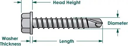

If you have metal studs, however, then you want self-drilling sheet metal screws. These have a drilling tip intended for cutting a pilot hole for the sheet metal screws to follow (see below). One of their virtues is that these screws would take a tremendous amount of effort to puncture a protection plate--sorry for carrying on about those. Self drilling screws include the self drilling tip in their named length, e.g. 3/4" screws would be too short for a 5/8" total thickness application. For your screw lengths, I would add 1/2" to your total thickness to get a few threads through everything (your total thickness includes your metal stud, the drywall, and your shelf bracket--no protection plate in there).
Here's what those screws look like, although you can get different driver types:
Self drilling sheet metal screw
