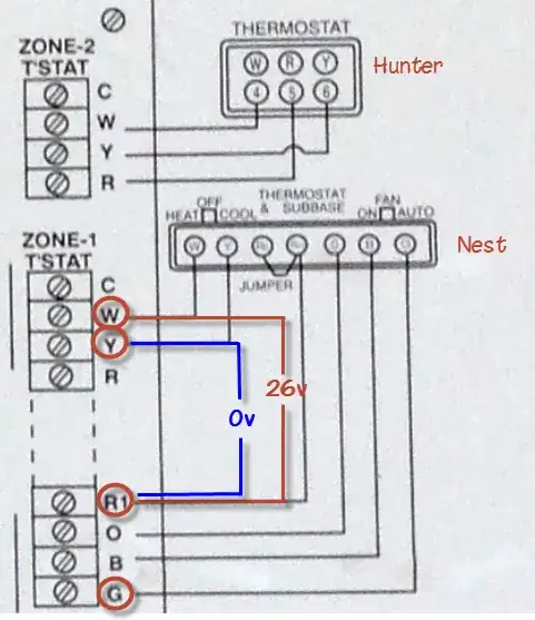

When I tested the voltages between R and W, I get a healthy 26 volts at the thermostat and at the control board. But on R and Y, I get 0 volts. The AC works fine with my old Lux thermostat (I verified by re-installing it), however, I also connected the B (blue) and O (beige) wires in the Lux thermostat. From what Nest tech support tells me, I don't need to use B since the Nest can grab power off of the R.

I put together the following diagram to describe the configuration:

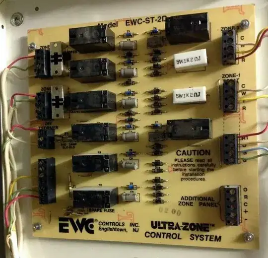

A picture of the control board:

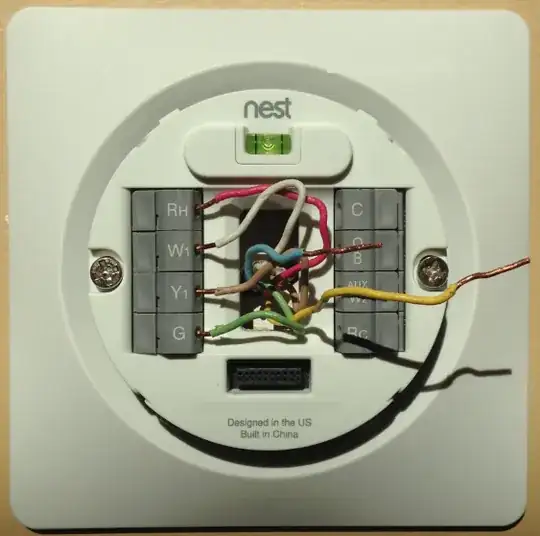

The Nest with the beige wire in Y1:

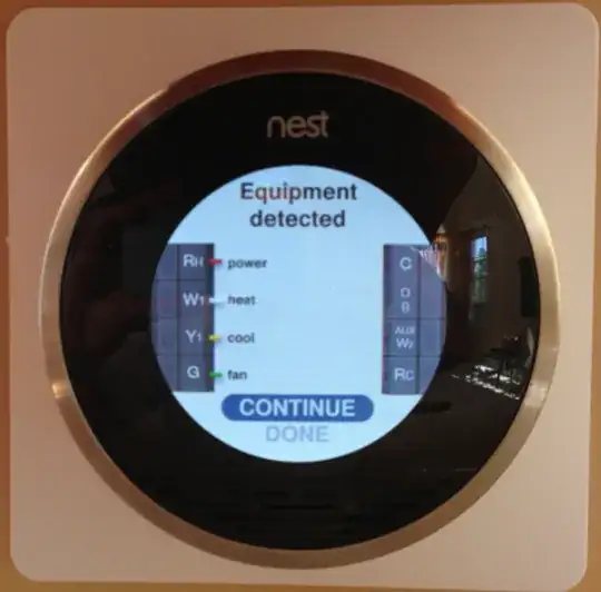

Which it happily accepts, and thinks that the AC is connected:
Update: I disconnected all the wires on the thermostat side of the control board and tested with my multimeter again. Same result: R1 to W gives me 28 volts, and R1 to Y is 0 volts.

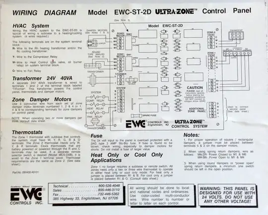

I just found a technical bulletin for the EWC-ST-2E Control Panel (seems similar to the EWC-ST-2D that I have). Will try to do some more troubleshooting after reading this.

This has been idle a while, but my guess is you need to connect the Nest to the R terminal of thermostat 1 on the controller instead of R1.
It looks like your control system was designed and wired for a heatpump but you no longer have one (there are only 4 wires on the lower left block which I think is the output to the furnace/AC compressor). If so the O and B wires are unneeded and can be removed from the control panel.
So what I would try:
  1. Zone 1 R to Nest Rh (24VAC Hot)
  2. Zone 1 C to Nest C (24VAC Common)
  3. Zone 1 W to Nest W1 (Heat)
  4. Zone 1 Y to Nest Y1 (Cool)
  5. Zone 1 G to Nest G (Fan)
Only thing I don't understand is how the fan gets turned on by the second thermostat in Cool mode. (In cool usually the thermostat has to tie both G and Y to R (24VAC Hot), in heat only W has to be tied to R (+24VAC Hot)... Since it works it must be something the controller does automatically.
By connecting the Nest to the C terminal it gets access to 24VAC without trying to power it self from "leakage current".
It you want to test, jumper Zone 1 R to Y for a minute and see what happens. Does the compressor come on outside? Does the interior blower fan?
Double check this against the manuals..
