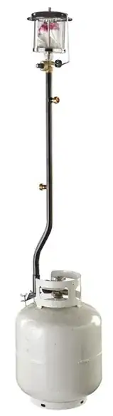

If you're not married to the idea of using batteries and LEDs, consider using a BBQ propane tank with an extension pole for a propane lantern. It works at any temperature, it makes as much light as a 60-100W incandescent bulb, and it's virtually maintenance-free. No reason you can't use two of them to eliminate shadows.
If course, if the work you're doing out there involves flammable liquids, this may not be the best solution, but it's worth considering otherwise.

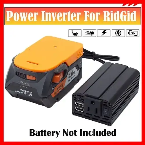

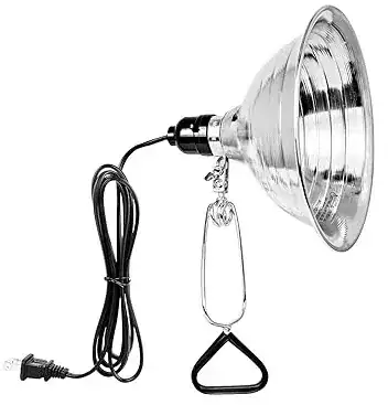

I am invested in the Ridgid 18v line of power tools so my answer is a bit biased towards my existing inventory.
I would get 2 or 3 pure sine-wave inverters, a few extension cords, and a few cheap-o clamp lamps with the aluminum reflectors.
Ridgid 18v pure sine-wave inverter
clamp lamp with aluminum reflector
