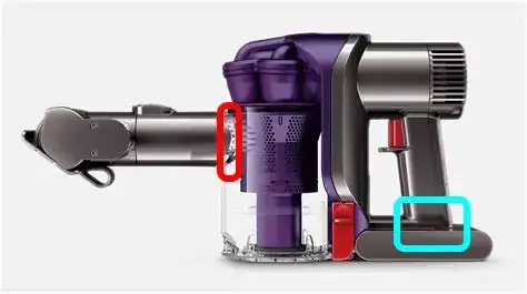

I don't know which model you are referring to [that sequence returns no hits except presumably your own question cross-posted on iFixit], but some can also get blocked where the red rectangle is marked, which can stay blocked even after emptying the bin. This, though, wouldn't stop the intermittent motor if you removed the hose.
On the battery theory, when the unit decides the battery is terminally ill, it will flash the charging lights, usually in the blue square, 32 times [yes, precisely 32*] every time you try to switch it on.]
*If you ever speak to Dyson support on the phone - which I'd recommend especially in the UK, they're very good - then they will ask you to count colours & numbers of flashes; it's how they can tell you what the fault is & what you need to do to remedy it.
