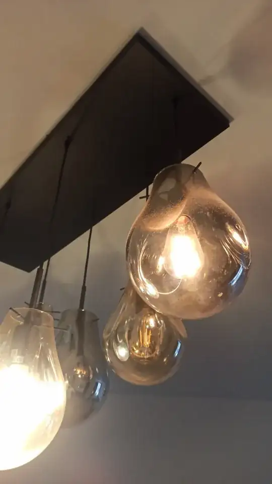

I want to clean this glass globe but I have no idea about how to remove it. Any suggestions? The image containing the bulbs

Attempt to unscrew the rods.
There's actually a high likelihood that all three rods will unscrew, meaning you can easily remove any two of them, then slide the globe off the third rod. You'll want to leave one screwed in place to help reduce the chance of dropping the globe when removing and reinstalling.
It was probably shipped with none of the horizontal rods installed to make the packaging easier at the factory.
