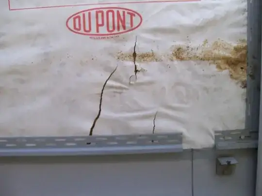

It may no longer be the case, or perhaps in this one, but Tyvek cannot handle long term UV exposure, and would figure that the underside of the home will at least get some exposure, even if it is indirect. After a period of time the Tyvek becomes very weak, like notebook paper and may not be able to handle a stiff breeze or wind. I used Tyvek on my home and evidently, did not cover it in the time specified and when I did a chimney addition I found this. I wasn't pleased at all.
