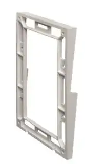

There are "counter shims" for siding
but A) they are the size of one-gang electric boxes so you'd have to use a bunch of them for your charger, and B) they are designed for vinyl siding, which is hollow and soft and very much needs these.
There's this one, a 7"x10" panel intended for outdoor sconces. IDK if it would suit your charger and it would look hilarious if it did, but ... you asked?
