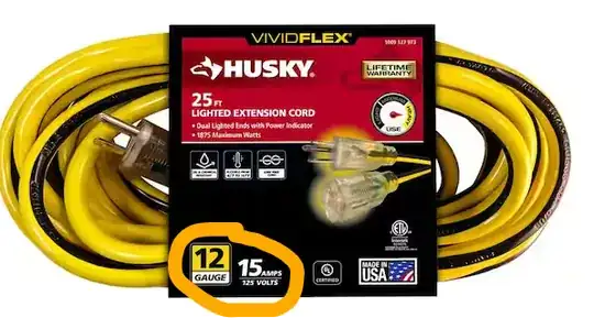

Heavy Duty
As mentioned, some outdoor extension cords are already sized appropriately. Now that you know what the gauges mean, you can shop smarter, looking for the higher gauge wire.
12 gauge extension cord
A minor note of caution here: a 12 gauge extension cord can handle 20A. Take care not to buy one with a 20A plug on it (one blade will be perpendicular to the other), or you will have to have a 20A receptacle to plug it into.
I didn't need an outdoor version, however, so I bought the indoor version. These are often marketed as an "appliance extension cord", or an "air conditioner extension cord". These are always 14 gauge or 12 gauge, and will handle a full 15A easily. I have one of these powering my 14A water heater
Appliance Extension Cord
